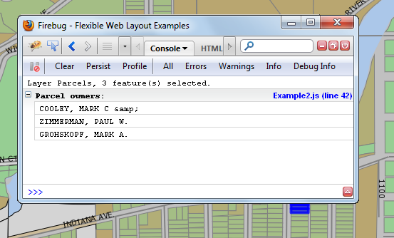

This example writes information about the currently selected parcels to the Firebug console. For more information about selections, see The Map Component and Working With Selections.

Example2.js combines these concepts to write the owner names of selected parcels to the Firebug console.
