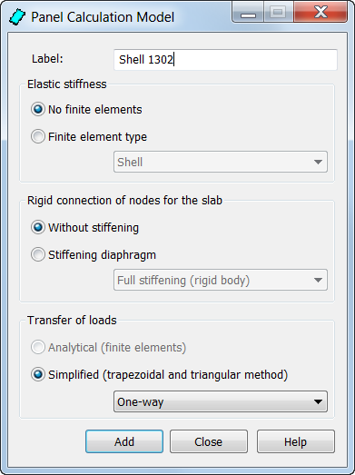

- Parameters of the panel calculation model for a slab must be set to No finite elements.
In Robot, to modify this setting:
- Select the slab.
- Click Geometry > Properties > Panel Calculation Model.
- In the Panel Calculation Model dialog, double-click Deck slab (one-way).
- In the dialog with parameters of a panel calculation model, for Elastic stiffness select No finite elements. Click Add and Close.
Note: You cannot modify the default set of parameters. Change the default Deck slab (one-way) label to save changes.
- In the Panel Calculation Model dialog, verify if the Panel field displays the panels to which the calculation model should be assigned.
- Click Apply and accept changes in the model.
Note: After the model is changed, perform static calculations to obtain up-to-date results.
