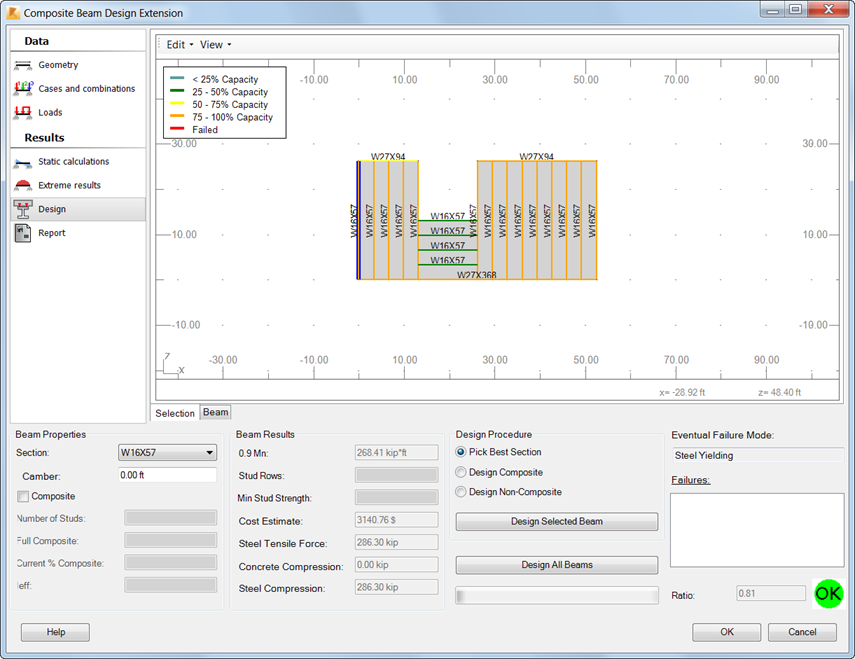

- Design options. To start design, click on of the following:
- Design Selected Beam. It automatically selects the optimum section, number of studs, and camber for the beam selected in the graphic viewer.
- Design All Beams. It automatically selects the optimum section, number of studs, and camber for all selected beams based on the internal forces resulting from the method of calculating forces you selected.
Design results include:

In addition, the graphic viewer presents studs designed on the beam.
After design is finished, click OK to update the Robot model with changes in section, number of studs, and camber, and close the extension.
