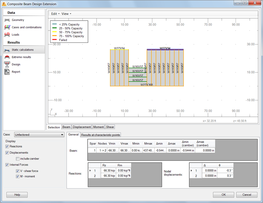

Use the Static calculations tab to:
To view results, from the Case field, select a load case or combination. On the General tab, static analysis results for beam, reactions, and nodal displacement display then.
Right-clicking a point opens the Results at characteristic points tab displaying results for the points you select.
To specify characteristic points on the beam, on the Results at characteristic points tab, you can also:
To display a diagram, under Display select a result type: Reactions, Displacements, or Internal Forces. Then a tab with a corresponding diagram is added at the bottom of the graphic viewer. Click this tab to view a diagram.
You can display the following results:

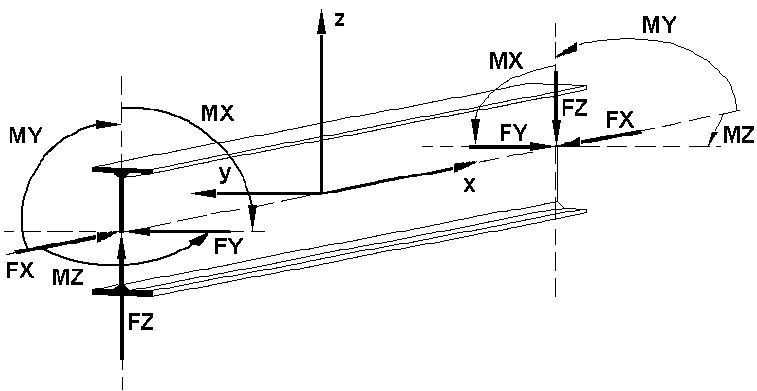

Sign convention (positive directions of forces and moments)
