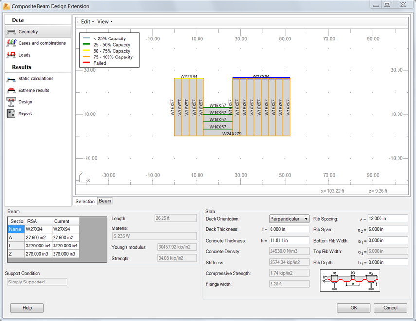

Use this tab to:
Specify Deck Orientation to determine the effective thickness of the slab (according to ANSI/AISC 360-10 I3.2c). See Orientation of the slab.
Select it to ignore the concrete below the top of the deck ribs in calculation of the effective thickness of the slab (according to ANSI/AISC 360-10 I3.2c).
Select it to include the concrete in the deck ribs in calculation of the effective thickness of the slab (according to ANSI/AISC 360-10 I3.2c). You can select parallel if the deck is parallel or nearly parallel to the beam.

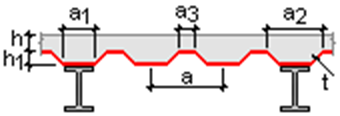

If you defined an RC slab in the model, fields with trapezoid plate parameters are automatically filled out with zeros. You can specify your values for these parameters.
To access beam diagrams, click the Beam tab under the graphic viewer.
