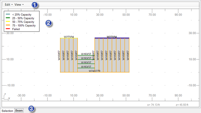

Graphic Viewer
The graphic viewer displays an analyzed structure, single beam, result diagrams, load diagram, or calculation note, depending on a tab and settings you select. It is available on each tab of the Composite Design Extension de poutre window.
1. Menu
Edit
  • Composite settings. They include default settings for the design, beam and slab materials, studs, and deflections and camber. You can customize these values.
    Note: On the Static Calculations tab, the Edit menu also contains:
  • Characteristic point. Use it to select characteristic points on a beam selected in the graphic viewer and display results for these points.
  • Delete. Use it to delete a selected characteristic point directly in the viewer.
View
  • Settings. Opens the View settings dialog where you select elements to display in the graphic viewer.
  • Zoom All. Zooms to a view of the entire model.
  • Zoom In Rectangle. Zooms in to a selected area.
  • Scale. Scales objects in the structure view.
File
    To access the File menu, select the Report tab, and then, in the graphic viewer, select the Report tab.
  • Export to Microsoft Word. Sends a calculation note to a Microsoft Word® document.
  • Export to Microsoft Excel. Sends a calculation note to a Microsoft Excel® document.
  • Save As. Saves a calculation note as an MHT or HTML file.
  • Print. Prints a calculation note.
2. Ratio Legend
It presents percentage ranges of the ratio and the corresponding colors. In the graphic viewer beams are marked with colors. Each color represents the percentage range in which the beam ratio is included.
3. Tabs
  • Selection. It is available on all tabs in the application. Displays an analyzed structure.
  • Beam. Displays a beam you selected in the graphic viewer and diagrams of shear, moment and displacement.
  • Displacement, Moment and Shear.
    To access these 3 tabs, click the Static calculations tab, and then select results to display: Displacement, M - moment, and V - shear force, respectively.
  • Report. Displays a calculation note with design results.
    To access a calculation note, click the Report tab, and then select Report at the bottom of the graphic viewer.

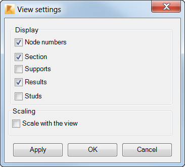

View Settings
To access view settings, select View > Settings.
    You can select the following objects to display in the graphic viewer:
  • Node numbers
  • Section
  • Supports
  • Results
  • Studs.
Select Scale with the view to scale diagrams while you are zooming in or out the model.
Scale with the view is off
Scale with the view is on
