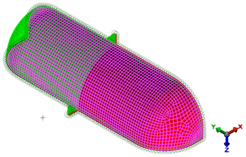

  1. Click  View Navigate Orientation Axonometric View.
  2. With the Selection Shape Point or Rectangle and Selection Select Surfaces commands active, click one of the surfaces on the interior of the pressure vessel.
  3. While holding down the Ctrl key, click the four other interior surfaces that are currently visible. The model will appear as shown below.

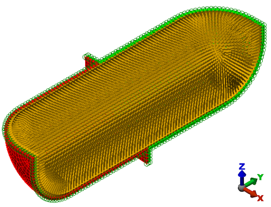

  6. Click Setup Loads Pressure.
    1. Type 100 in the Magnitude field.
    2. Click OK. The model displays as shown in the following image.
