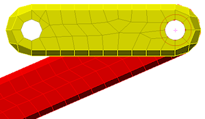

  4. With the  Selection Shape Circleand Selection Select Surfaces commands still active, draw a circle enclosing the hole where the connecting rod and crank meet, as shown in the following image.
  5. Click Add in the Joint Mesh Setup dialog box. Two surfaces are added to the Participating surfaces list, one from the crank and one from the connecting rod.
  6. Click OK to add the pin joint, which appears as shown in the following image.
