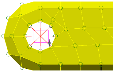

  1. Click the Right face of the ViewCube for a right side view of the model.
  2. Use View Navigate Zoom Window to zoom in on the area around the joint at the free end of the crank.
    Note: This command can also be accessed from the Navigation Bar, or you can roll the mouse wheel to zoom in.
  3. With the  Selection ShapePoint or Rectangle and  Selection Select Vertices commands active, click and drag to draw a box enclosing the center of the joint.

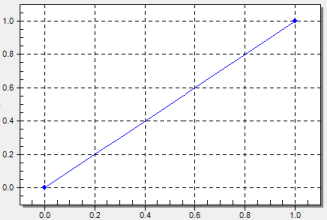

    3. Click the Curve button. The default curve ramps up the multiplier from 0 to 1 in 1 second.  This is what we want. The curve within the dialog box should look like the image below.
      • Click OK to exit the Multiplier Table Editor.
