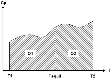

The equilibrium temperature can be thought of as the temperature at which the selected elements would obtain if they were allowed to come to equilibrium, without losing any heat to the environment. It is based on the following methodology:
integral of (mi x Cpi x dT) divided by integral of (mi x Cpi), both integrated over the range of Ti to Tequil.
This is easy to visualize for a two mass system. The heat lost by one mass (integral of m2 x Cp2 x dT over the range T2 to Tequil) is equal to the heat gained by the other mass (integral of m1 x Cp1 x dT over the range of T1 to Tequil), so the areas under the graph of specific heat versus temperature are equal. See Figure 1.
Figure 1: Equilibrium Temperature Calculation for Two Masses
The equilibrium temperature Tequil is the temperature at which the amount of heat lost by one mass, Q2, equals the heat gained by another mass, Q1. The area under the curve of the specific heat Cp versus the temperature T is equal for Q1 and Q2.
