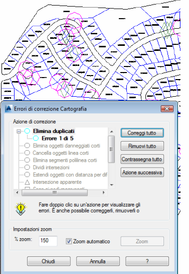

Clean Up Drawings
Using Drawing Cleanup tools, you can automate the correction of common drafting and digitizing errors. Delete duplicates, correct undershoots and dangling objects, and more.
Review, mark, and correct errors interactively.
