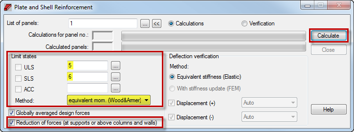

Learn how to set the calculation options and how to start the calculations of the required reinforcement area.
Required Reinforcement of RC Slabs/Walls.
The Slab - Required reinforcement layout opens. The layout is divided in three parts: View, Reinforcements dialog, and Plate and Shell Reinforcement dialog.
The Calculation Status dialog opens and displays information about the admissible plate deflection value which has been exceeded.
