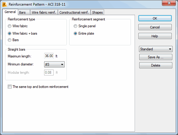

Reinforcement pattern - General
Select the General tab on the Reinforcement pattern dialog to determine the general parameters concerning a plate.
The Reinforcement type field determines if the main reinforcement of the plate is to be made of wire fabric, bars, or both (currently unavailable).
The Reinforcement segment field determines if the plate reinforcement is to be made in the following.
The Straight bars option determines the maximum length of straight bars for reinforcement, as well as the value of the diameter from which the condition applies. Additionally, the modular length option determines the value (module) up to which the bar length is to be rounded up. For instance, a bar with the length 5.36 m in the first run, then after typing the value 0.10 m, the bar length value = 5.40 m.
