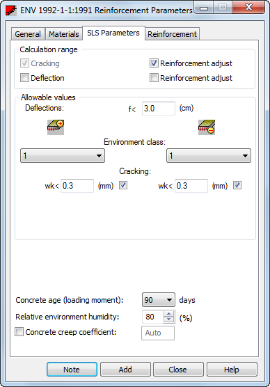

Reinforcement Parameters - SLS Parameters tab (RC slab)
The SLS Parameters tab allows you to define parameters for the calculation of cracking and deflections of the plate-shell structure.

Calculation range
Define the range of calculations in the Serviceability Limit State (SLS) while designing an RC plate (panel).
  • Cracking. Calculations of the cracking width.
  • Reinforcement correction (cracking). Automatic correction of cracking width by increasing reinforcement area.
  • Deflection. Calculations of the RC plate deflection with cracking considered.
  • Reinforcement correction (deflections). Automatic correction of deflections by increasing reinforcement area.
Allowable values
You can define the allowable values of cracking width and/or of deflection. If these values are exceeded, the results table will report relevant information.
Cracking width is defined in two ways (separately for the top and bottom areas).
  • Choose the environment class resulting in a cracking width in accordance with code requirements.
  • Enter a value of cracking width. A change of the environment class has no effect on the adopted value of the cracking width.
If the Reinforcement correction option is selected, the defined values are also the limit values. Reinforcement area is increased for these values to be reached.
Additional parameters
You can determine the ratio of variable loads to long-term loads.
  • Variable loads may be divided into short-term and long-term loads. The long-term to variable coefficient specified in the Ratio of loads is used to split variable loads into a short-term part and a long-term part according to the following formula.
    variable load = (1 - c) * variable load + c * variable load = short-term load + long-term load,
    where c is a coefficient of the participation of long-term loads in variable loads.
You can also specify:
  • Concrete age (loading moment) is used in calculations of modulus of elasticity of the concrete.
  • Environment humidity may also be entered.
  • Concrete creeping coefficient The concrete creeping coefficient may be selected automatically in compliance with code requirements after defining the concrete age at the loading moment.

The dialog may include additional RC code specific parameters such as the following.
  • American code: how long a long-term load is acting on the structure, x coefficient.
  • UK code: concrete age (part 7.2 of BS 8110), concrete creeping coefficient (fi according to Figure 7.1 in BS 8110), relative environment humidity (Figure 7.1 in BS 8110).
  • Polish code: concrete age, concrete creeping coefficient.
  • Eurocode 2: allowed nonlinear creep - according to the EN 1992-1-1:2004 AC:2008 code with all National Annexes [point 3.1.4(4)].
