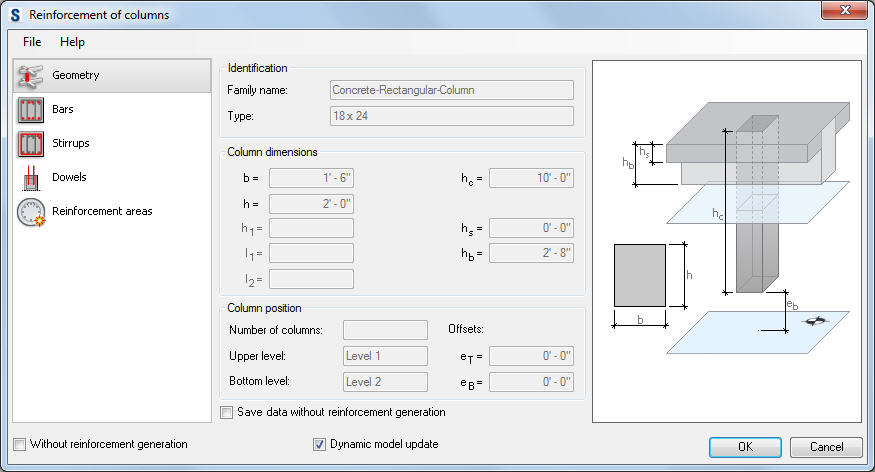

Reinforcement of Columns - launched from Autodesk® Revit®.
Parameters of section geometry include:
If the Save data without reinforcement generation option is cleared, the reinforcing bars are generated and displayed in Autodesk® Revit®. If this option is selected, the reinforcement data is generated (and can be used after restarting the Extension), but reinforcing bars cannot be displayed in Autodesk® Revit®.

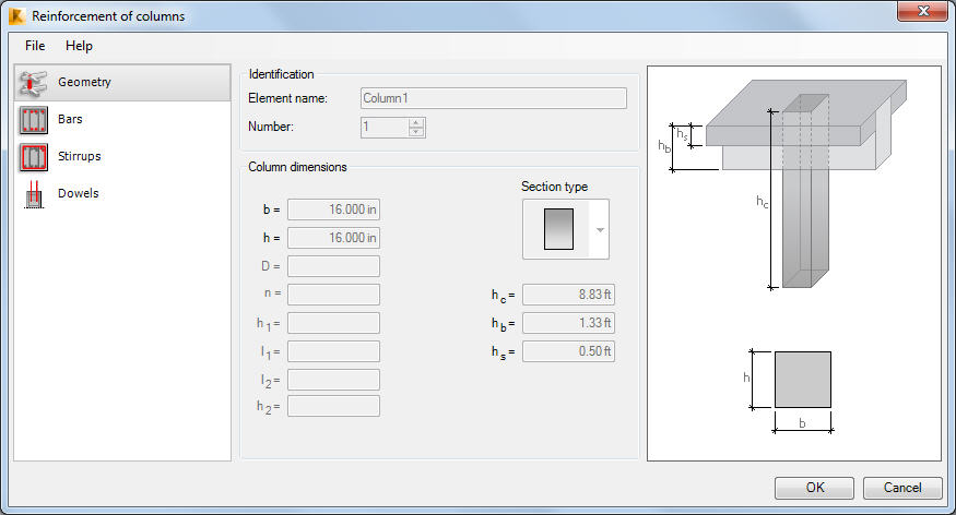

Reinforcement of Columns - launched from Autodesk Robot Structural Analysis 2016
Parameters of section geometry:
The reinforcement is generated for the following column shapes:
rectangular section
round section
L-shaped section
T-section.
It is possible to define other types of column sections (e.g. Z-section, half-circle section etc.) but the column reinforcement is not generated for these section types.
