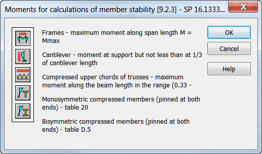

Use this dialog to define additional parameters of stability analysis for bent members for the Russian code SP16.13330.2011.
Access
- Click More in the Member Definitions - Parameters dialog, and then click one of the moments icons.
Note: The SP16.13330.2011 code replaces the former SNiP II-23-81 version of the code for steel structures. Therefore, all references to tables or sections of the code apply to the SP16.13330.2011 code except otherwise stated.
Dialog elements
The options included in this dialog enable defining schemas of bending moment distribution along the length of an analyzed element. This information is applied in stability verification of elements subjected to simultaneous action of compressive force and bending moments (see point 9.2.3, Table 20 and Annex D).
Note: If you are using the SNiP II-23-81 version of the code, refer to point 5.29 of the code.
