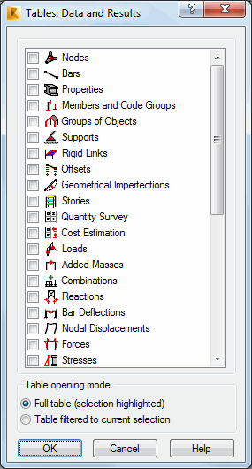

The Tables: Data and Results dialog lets you select tables for the presentation of data or calculation results.
- Access
- Click View
Tables
- Click Tables from the context menu
- Click
- Dialog elements
- Data tables
- Results tables
- Table opening mode
The following options at the bottom of the dialog specify how the data or results tables are opened:
- Full table (selection highlighted) - When selected, the entire (full) table is opened. The rows that are assigned to the selected nodes, bars, or objects are highlighted.
- Table filtered to current selection - When selected, only the rows assigned to the selected nodes, bars, or objects are displayed.
Note: If you display a results table, and there are no current structure calculation results, Robot automatically begins structure analysis and calculates the selected quantities.
