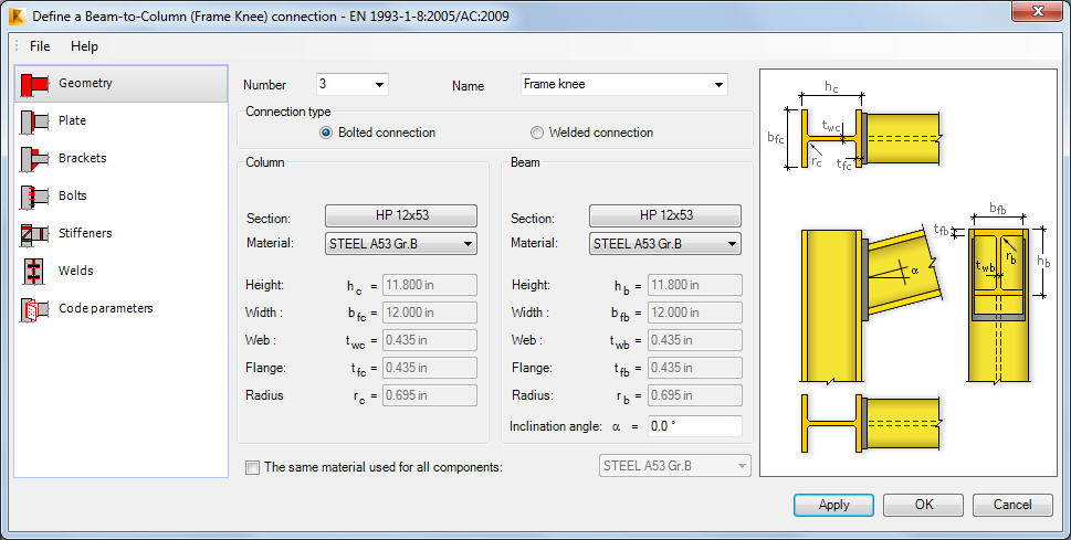

Geometry
Parameters of geometry of the beam-to-column steel connection include:
2 types of beam-to-column connection can be defined:
Geometrical and material parameters of the steel column and the steel beam for which to create a connection, display in the center of the dialog.
After selecting The same material used for all components, the beam and the column are made of the same material.
Note: The number of tabs in this dialog depends on a selected connection type: bolted or welded.
