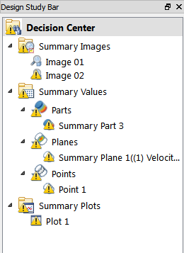

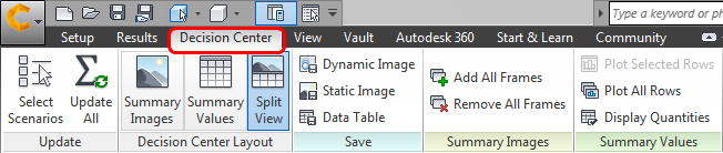

After capturing Summary items, compare them in the Decision Center. To open the Decision Center, click the Decision Center tab:
The Decision Center appears in the Design Study Bar:
The following symbol means that a Summary item either has not been mapped to the other scenarios or that the results have changed since the last time it was mapped:
To update the Summary item, click Update All from the Decision Center tab:
Alternatively, right click on Decision Center, and click Update all:
You can update individual Summary items by right clicking on them and selecting the update command.

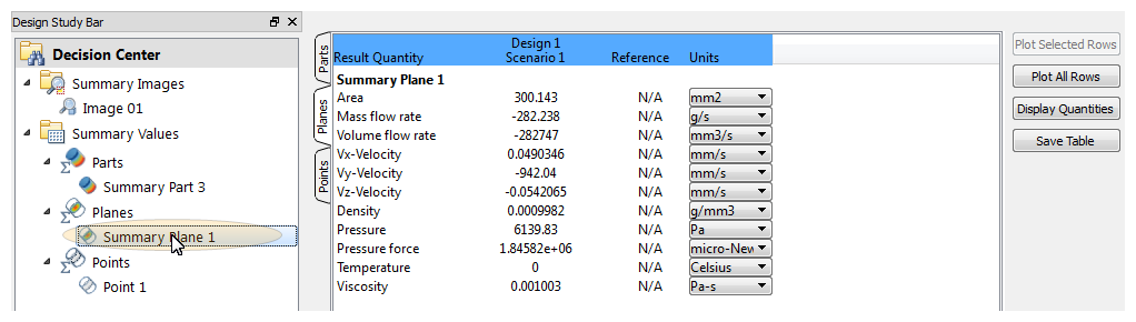

Use Summary Values to compare data from Summary Planes, Summary Points, and Summary Parts. To view the Summary Values table, click on a summary entity in the Decision Center.

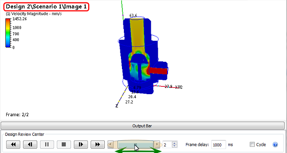

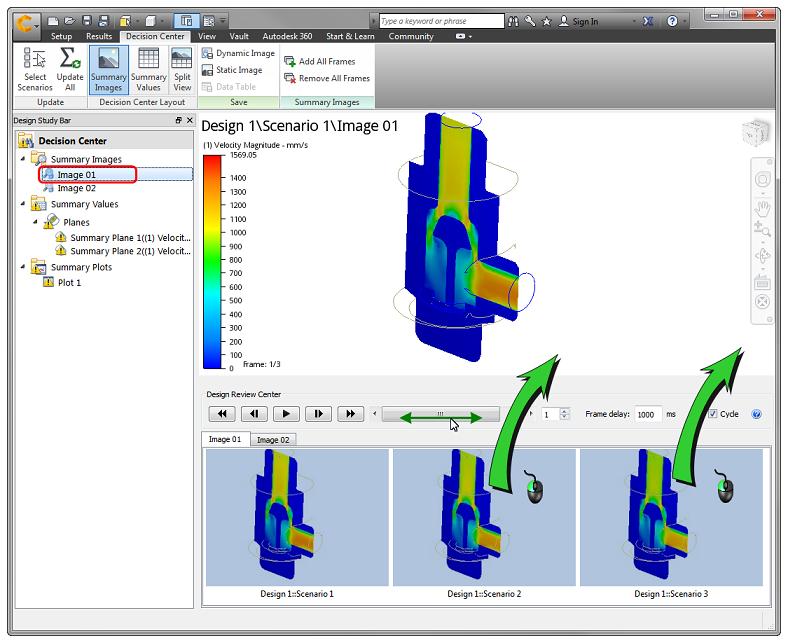

Use the Design Review Center to compare visual data with captured Summary Images. Click the image name in the Decision Center, and the image for each scenario appears in a separate thumbnail image in the Output bar. To add a thumbnail view to the display, drag it into the graphics window.
To view multiple images, drag the slider or use the "VCR" controls to flip between each design or scenario:
You can also divide the model screen into multiple viewports to compare results side-by-side:
Do this with View > Window > Viewports.
