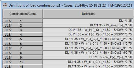

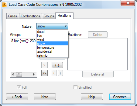

Learn how to generate automatic load case code combinations.
Load case combinations, which are generated automatically, are used to check resistance and serviceability for real situations in which various loads act simultaneously, as defined by a specific code. If required, you can define the action combinations manually, one by one.
to edit the code combination regulations.
