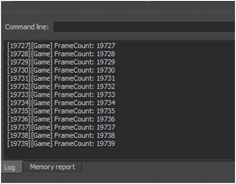

    // Sends a message to the Log window of the Navigation Lab
    static KyUInt32 framecount = 0;
    KY_LOG_MESSAGE(("FrameCount: %d", framecount));
    framecount++;

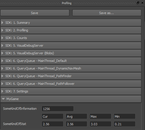

    // Sends a single data value
    KyUInt32 someKindOfInformation = 1256;
    visualDebugServer->SendUInt32("SomeKindOfInformation", someKindOfInformation, myCategoryName);
    // Sends current, average, max, and min stats computed by the game
    const char* someKindOfStat = "SomeKindOfStat";
    KyFloat32   currentValue   = 2.56f;
    KyFloat32   averageValue   = 2.56f;
    KyFloat32   maxValue       = 3.026f;
    KyFloat32   minValue       = 0.21f;
    visualDebugServer->SendStats(someKindOfStat, currentValue, averageValue, maxValue, minValue, myCategoryName);

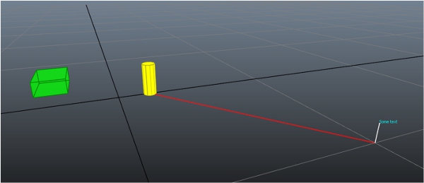

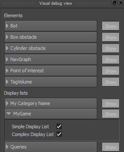

        // Create a display list and send a line
        Kaim::ScopedDisplayList displayList(m_world, Kaim::DisplayList_Enable);
        displayList.InitSingleFrameLifespan("Simple Display List", myCategoryName);
        displayList.PushLine(positionB, positionB + Kaim::Vec3f::UnitZ(), Kaim::VisualColor::White);
        // The ScopedDisplayList is automatically sent to the Navigation Lab
        // when it goes out of scope.
        // Create a second display list and send more shapes
        displayList.InitSingleFrameLifespan("Complex Display List", myCategoryName);
        Kaim::VisualShapeColor shapeColor;
        shapeColor.m_triangleColor = Kaim::VisualColor(255, 255, 0);
        shapeColor.m_lineColor     = Kaim::VisualColor(175, 175, 0);
        displayList.PushVerticalCylinder( positionA, radius, height, 10, shapeColor);
        displayList.PushLine( positionA, positionB, Kaim::VisualColor::Red);
        shapeColor.m_triangleColor = Kaim::VisualColor(0, 255, 0, 128);
        shapeColor.m_lineColor     = Kaim::VisualColor(0, 128, 0, 255);
        Kaim::Box3f someBox(boxLowerCornerPosition, boxLowerCornerPosition + boxExtents);
        displayList.PushBox(someBox, shapeColor);
        displayList.PushText( positionB + Kaim::Vec3f::UnitZ(), Kaim::VisualColor(0, 255, 255), "Some text");
        // Again, the ScopedDisplayList is automatically sent to the Navigation Lab

Navigation Lab을 게임에 연결하면 이제 다음이 표시됩니다.
