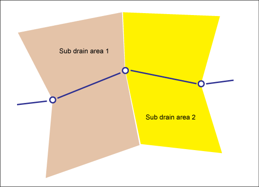

To Create a Sub Drain Area
Use the Sub Drain Area Creation workflow to create a sub drain area. You can add a higher level drain area.
Sections can be assigned to sub drain areas.
