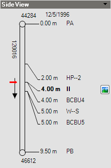

Side View
The Side View section displays a graphical representation of an inspected section of pipe between a from manhole and a to manhole along with their unique feature IDs.
Note: The ‘from manhole’ is always at the top of the side view.
To the left of the section representation is an arrow which indicates flow direction. To the right of the section representation is a list of distances and corresponding damage codes.
Double-clicking a damage code changes the description data shown in the Description section and also advances or rewinds the video to that location along the section. If an image icon is present, it means there is a still image associated with that observation point which you can view.
Note: If multiple observations are within 2 meters of one another, double-clicking or moving the slider over one of the observations with auto-highlight or auto-zoom all the observations. This occurs only when Auto Highlight or Auto Zoom are active.
Hovering the cursor over a damage code displays a menu where you can choose to highlight or zoom to the damage, open a form, delete the damage observation, or fix the damage observation. Navigating the red arrows in the side view to different damage observations will also advance or rewind the video display to the selected observation.
