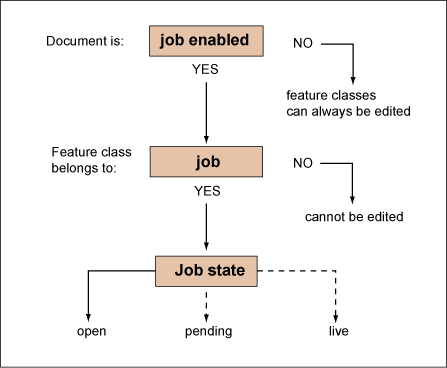

To work with job-enabled feature classes, you must create a job that contains those feature classes. Use job templates to do this.
A job template contains pre-defined feature classes that can be processed in the jobs that are created from this template. You cannot modify or delete job-enabled feature classes that are not in this job.
You can combine feature classes from different topics into one job template. When you create a job from this template, you can change the state of each topic separately.
Note: You must job-enable an industry model before you create job templates. See Job-Enable an Enterprise Industry Model. Only Oracle-based enterprise industry models can be job-enabled.
Job-enabled feature classes can be edited only if they belong to the current job. A job can be processed only if its state is open.
Job enabled feature classes can be edited only if they belong to the current job. A job can only be processed only if its state is open.
