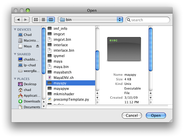

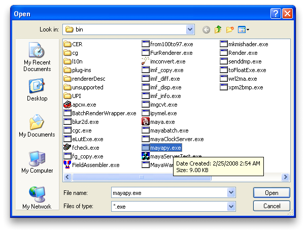

Next, you can either copy and paste the path to your maya interpreter (aka mayapy) or you can click ‘Browse’ and navigate to it.
Note
On OSX, browsing to mayapy is not as easy as it should be. The problem is that it’s buried within Maya.app, which you cannot access in a file browser (thanks Apple!). To get to it, hold down Command+Shift+G to bring up a box to enter a path (that’s the Apple “Command” button, plus Shift, plus the letter G). You can’t use Command-V to paste a path in this browser, but you can right click in the path entry box and choose Paste.
Windows OSX C:\Program Files\Autodesk\Maya2009\bin\mayapy.exe /Applications/Autodesk/maya2009/Maya.app/Contents/bin/mayapy

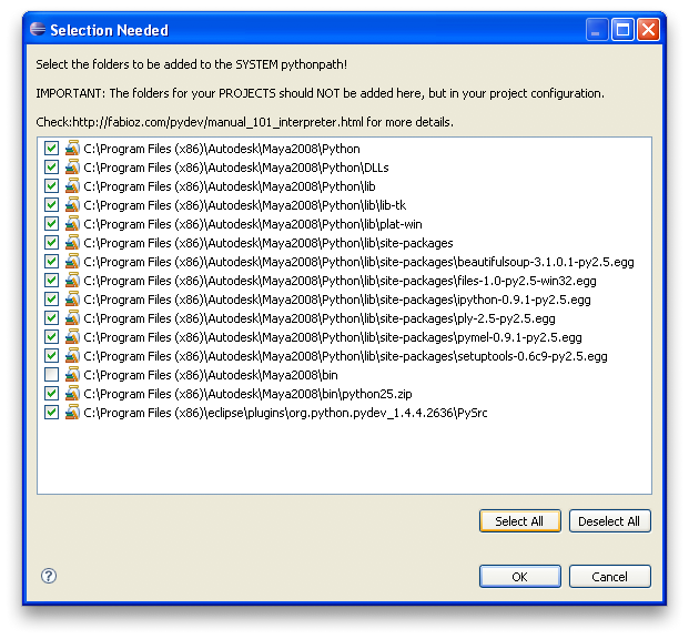

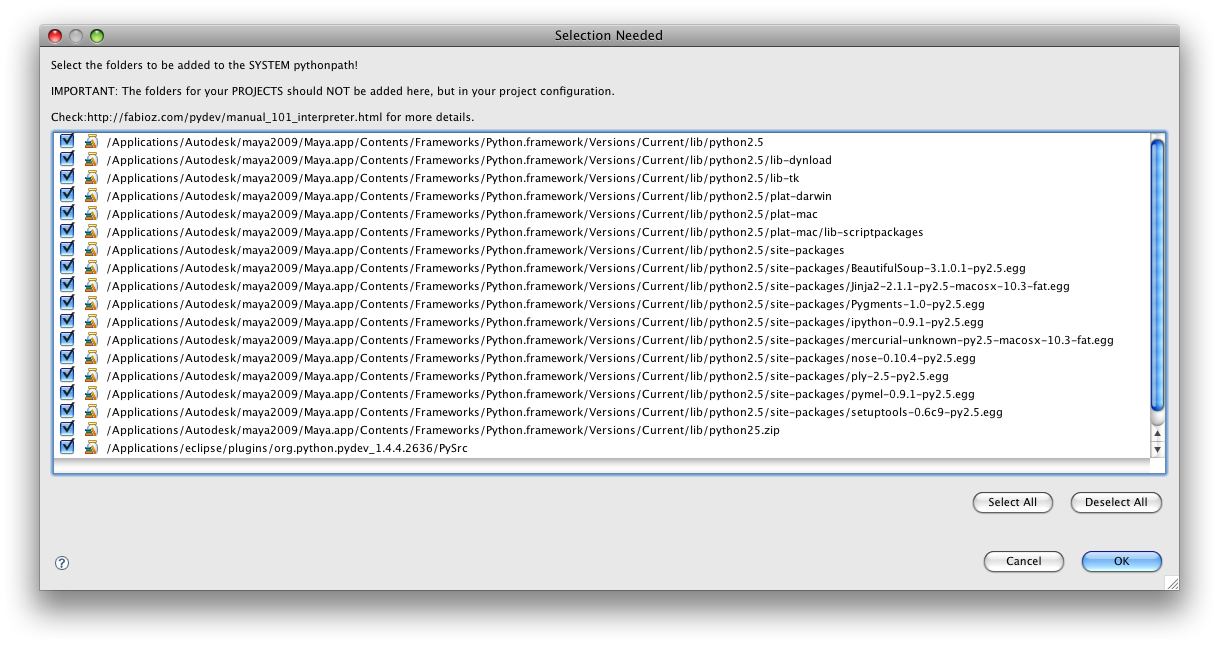

Once you choose the “mayapy” binary, you’ll get this window:
Windows OSX
On windows: add a check beside python25.zip
then press “OK”
- From the list, select the one path that ends with site-packages and click the “remove” button. Remember this path because we are going to re-add it later.
- If you installed PyMEL using the Easy Install method: you’ll see the pymel “egg” in the list of automatically detected site packages. Remove the pymel egg
- Click on the “New Folder” button. In the browser that pops up, navigate to the directory where you extracted the pymel zip file. Under it, there is a folder called extras, under that a folder called completion, and then finally one called py. Choose the py folder and press “OK”.
- Click the “New Folder” button again, and add the site-packages directory you removed earlier. We did this in order to ensure that the stub maya package is found before the real maya package. When you’re done, the main site-packages directory should be somewhere below the extras/completion/py folder you just added.

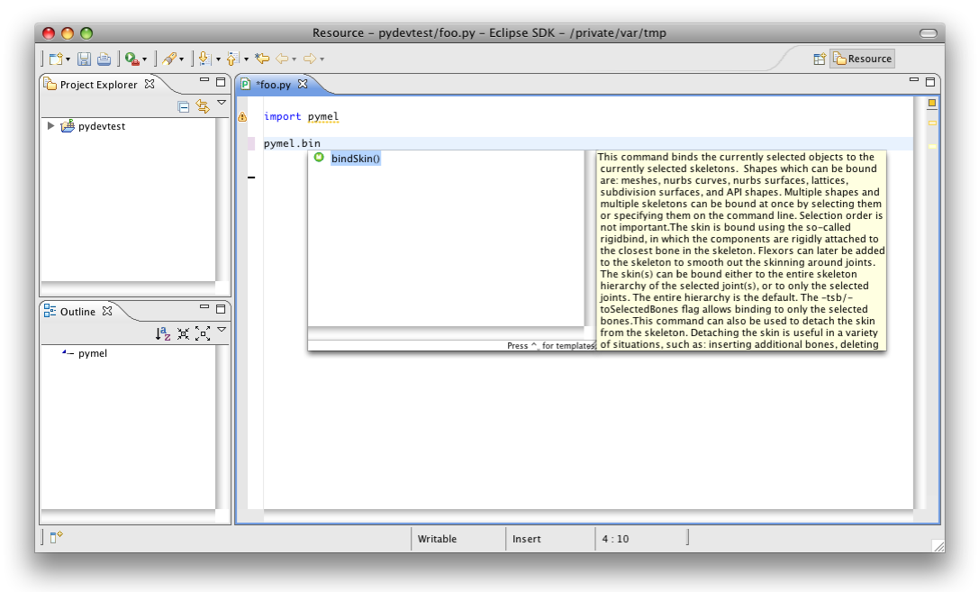

Now type:
pm.bin
you should get bindSkin() as a completion.
