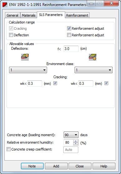

The SLS Parameters tab allows you to define parameters for the calculation of cracking and deflections of the plate-shell structure.
Required Reinforcement of Slab/Walls - Options
Code parameters to open the Plate and Shell Reinforcement Type dialog, and then click
Define the range of calculations in the Serviceability Limit State (SLS) while designing an RC plate (panel).
You can define the allowable values of cracking width and/or of deflection. If these values are exceeded, the results table will report relevant information.
Cracking width is defined in two ways (separately for the top and bottom areas).
If the Reinforcement correction option is selected, the defined values are also the limit values. Reinforcement area is increased for these values to be reached.
You can determine the ratio of variable loads to long-term loads.
Variable loads may be divided into short-term and long-term loads. The long-term to variable coefficient specified in the Ratio of loads is used to split variable loads into a short-term part and a long-term part according to the following formula.
variable load = (1 - c) * variable load + c * variable load = short-term load + long-term load,
where c is a coefficient of the participation of long-term loads in variable loads.
