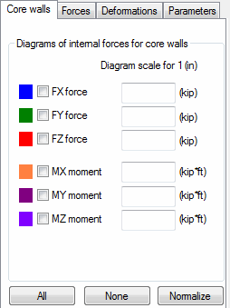

When the Core walls tab is selected on the Diagrams for buildings dialog, the following displays:

This dialog displays values for which the diagrams for the core walls will be presented.
For each of the values above, the appropriate color and scale can be selected.
Descriptions of directions (X, Y, Z) for the diagrams of forces and moments refer to the global coordinate system.
The diagrams are presented along the vertical axis cutting through the gravity centers of the core wall section on every story. Two cuts are performed for each story: above the bottom story edge and below the top story edge. Each cut is made at the centroid of the surface elements as shown in the drawing area.
