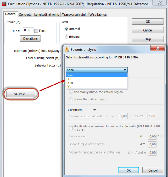

The following features have been implemented for the French Annex NF EN 1992-1-1/NA:2007:
The RC wall design and verification feature has been supplemented with seismic options for the French annex NF EN 1992-1-1 / NA:2007.
These options are accessible from the Calculation Options dialog for the French code.
For more information, see Calculations of RC walls according to NF EN 1992-1-1/NA:2007 (NF P 18-711-1)

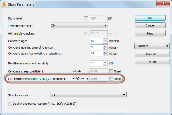

A new set of deflection options has been added to the calculation options for beams, according to the FFB recommendations from the NF EN 1992-1-1/NA:2007 code.
These new options are in accordance with the NF EN 1992-1-1/NA:2007 codes.

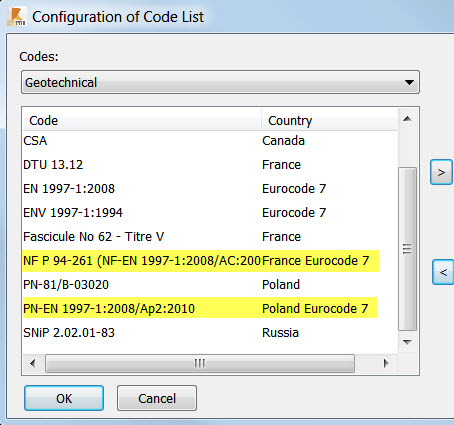

To find these new codes:
Job Preferences
Design codes. The list of geotechnical codes displays.
