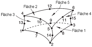

5-Knoten-Pyramide
C3D5
C3D5H
SOLID164 (Pyramidenoption)
SOLID185 (Pyramidenoption)
13-Knoten-Pyramide N/A
SOLID95 (Pyramidenoption)
SOLID186 (Pyramidenoption)
SOLID226 (Pyramidenoption)
