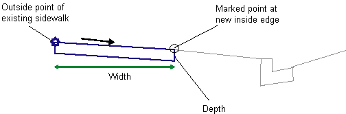

UrbanReplaceFootpath
This subassembly is used to replace an existing footpath, starting at the existing outside edge of footpath and inserting surfaces towards the kerb.
To use this subassembly, you should have separate alignments defining the existing outside edge of footpath information. Levels at this point could come from a surface or a profile. Furthermore, if the component defining this edge is also another rehab component, then they could be passed in as marked points, thus transferring offset and level information.

Behavior
By default outside edge of footpath is located at the attached marked point or at the associated alignment. Similarly level is set based on marker point associated, or profile or from the surface at that offset.
Once this start point is established,footpath structure links are inserted inwards from this point for given width, slope, and depth. If a name is given for Mark Inside Point, a marked point is stored at the new low edge of footpath.
Layout Mode Operation
In layout mode, this subassembly starts at the attached point and draws a single shape with given dimensions, such as width, slope and depth.
Note:
While constructing an assembly, it is recommended that this subassembly be added at a controlling offset, if there is no previously marked point. This controlling offset could be at a decent offset from the baseline marker, so that the layout mode looks like a typical section. However, it is recommended that the user doesn't have to map this controlling offset to any "alignment/profile" in the corridor state, as that would cause problems such as making the design not perpendicular to the baseline in some cases. Not associating this controlling offset will not have any effect on the corridor, as the start point is attached to an alignment/marked point through the subassembly macro for an exact location.
