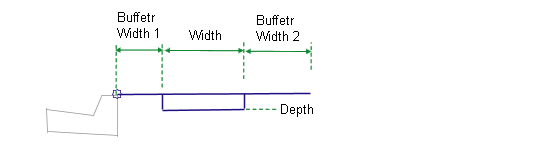

The links for the inside buffer zone, footpath, and outside buffer zone are inserted outward from the attachment point at a horizontal slope. The buffer zones may be omitted by setting their widths to zero.

Coding Diagram
