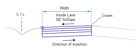

Point, Link, and Shape Codes
The following table lists the point, link, and shape codes for this subassembly that have codes assigned to them. Point, link, or shape codes for this subassembly that do not have codes assigned are not included in this table.
Point, Link, or Shape
Code
Description
P1
EC
Inside edge of lane on finish surface
P2
Crown
Outside edge of lane (at the crown point) on finish surface
P3
EC_Pave1
Inside edge of lane on Pave1
P4
Crown_Pave1
Outside edge of lane on Pave1
P5
EC_Pave2
Inside edge of lane on Pave2
P6
Crown_Pave2
Outside edge of lane on Pave2
P7
EC_Base
Inside edge of lane on the base layer
P8
Crown_Base
Outside edge of lane on the base layer
P9
EC_Sub
Inside edge of lane on the subbase layer
P10
Crown_Sub
Outside edge of lane on the subbase layer
L1
Top, Pave
Finish surface
L2
Pave1
L3
Pave2
L4
Base
L5
SubBase
Datum
S1
Pave1
S2
Pave2
S3
Base
S4
SubBase
Coding Diagram
