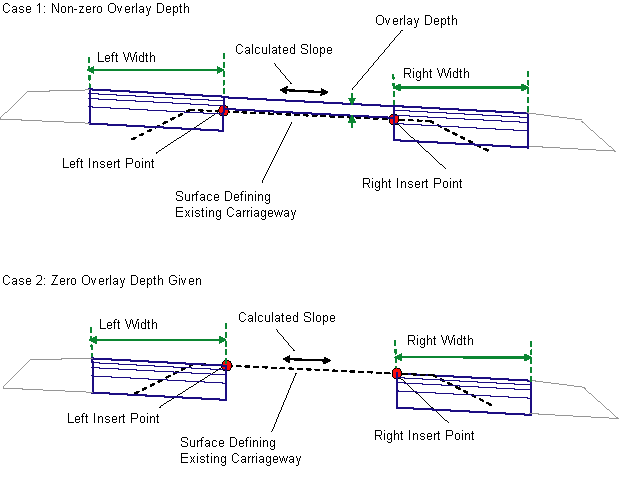

This subassembly overlays an existing uncrowned road, and adds one or more travel lanes to the left and right edges while matching the existing lane slope.
The attachment point is at the inside edges of the finish surface on the widening lanes.

The levels of the Left and Right Insert Points on the Existing Surface are determined, and the slope is calculated between the two points. If a non-zero Overlay Depth is given, an overlay layer is added above the existing lane at the calculated slope. A closed overlay shape is created by superimposing one or more links over the existing gradient. The widening lanes are inserted outward from the overlay edges for the given widths at calculated slope.
If the Overlay Depth is given as zero, the widening lanes are inserted outward from the insert offsets at the existing gradient.
The pavement layers are closed with vertical links at each end. A single vertical link is also placed from the inside edge of Subbase to the existing surface.

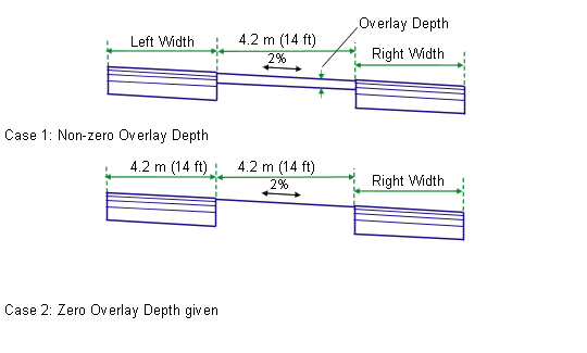

In layout mode, this subassembly is attached to any convenient point. The overlay layer is shown at a uniform depth for a width of 4.2 meters or 14 feet at a slope of -2%. The widening lanes extend from the edges-of-overlay at the given widths and depths at the -2% slope.
In modeling mode the subassembly adjusts to the positions and slopes determined by the Insert Points and the Existing Surface.
