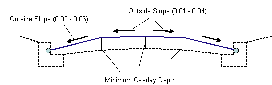

Quarter Points and Crown Point Offsets
The distance between left and right flange points is divided by four to get the two quarter points and the crown point. These points levels are computed by adding the minimum overlay depth to the existing ground at these offsets.
Inside and Outside Pavement Slopes

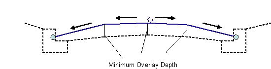

The resulting overlay links from the previous steps are checked for being within the slope tolerances for the outside and inside lanes. If the slopes are within the tolerance, then the case is a simple overlay as show in the following diagram.

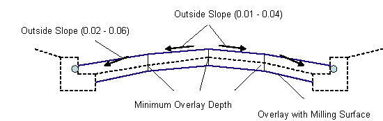

If the overlay links are too steep, or if the Maximum Breakover is exceeded at the centerline, or the Min Crown Deflection is not obtained, some or all links are flattened to their maximum slopes. Milling surfaces are inserted to hold the minimum overlay depths at the quarter points and centerline.
If overlay links are too shallow, the depth of overlay is increased to achieve the minimum slopes. If this results in too much breakover, further adjustments and milling may occur. The following diagram illustrates the overlay with milling case.

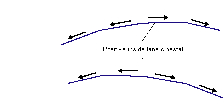

Special Cases
A positive slope may be allowed on one inside link if the other inside link has a negative slope, as shown below.
