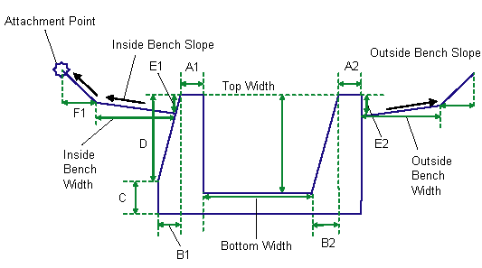

This subassembly creates a ditch structure with optional bench and backslopes on the inside and the outside of the structure.
The attachment point is the innermost point of the optional inside bench. If inside benches are omitted, the attachment point is on the innermost point of the inside wall of the ditch structure.
Note: All dimensions are in meters or feet unless otherwise noted. All slopes are in run-over-rise form (for example, 4 : 1), unless indicated as a percent slope with a “%” sign.

The subassembly builds the shape for a ditch structure, as shown in the illustration. To omit benching and foreslope links, enter zero for the appropriate width parameters.
In layout mode, this subassembly draws as it is defined using the input parameters, starting from the attachment point.
