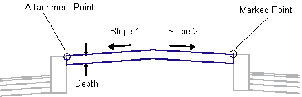

This subassembly inserts links for a constant-slope raised central reserve between two points.
Use the MarkPoint subassembly first if the connecting point has not already been marked.
The attachment point may be at either edge of the central reserve finished surface. The marked point must be at the opposite edge.

Depth
Depth of the central reserve cap. May be zero for an unpaved central reserve.
Numeric, positive
0.100 m
0.333 ft
Slope 1 - Use Superelevation
Specifies to use superelevation slope for central reserve towards crown point
Selection list No
Slope 1 Default
Specifies default value of slope 1, if superelevation slope is not specified Numeric - 2%
Slope 2- Use Superelevation
Selection list No
Slope 2 Default
Specifies default value of slope 2, if superelevation slope is not specified Numeric - 2%

The central reserve crown point is calculated by intersecting lines extended between the attachment point and the marked point at the given slopes. If no junction is found, the central reserve is not inserted. If a non-zero Depth is given, the bottom of the central reserve links are inserted parallel to the top, and vertical links are added to close the shape.
Superelevation Axis of Rotation Support
This subassembly works with all axis of rotation pivot methods.
This subassembly produces a raised crown. Even when it is used in a divided crown carriageway, the center of the central reserve will be higher than the central reserve edges.

Coding Diagram
