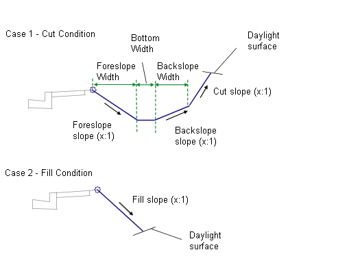

This subassembly is used to close from the edge of carriageway to a daylight point in both cut and fill conditions.
The cut condition includes an optional ditch. The final daylighting link can be omitted for cases where the corridor model needs to be left in an incomplete state. For example, this might be done so that grading surfaces on adjacent properties can tie to the hinge point on the uncompleted carriageway. This subassembly is one of a group of Getting Started subassemblies used for simple carriageway modeling, and for tutorial and training purposes.
You can also specify optional lined materials for daylight and other links (All Links, Daylight Links, Fill Links Only, and None).
The attachment point is at the inside edge of the ditch foreslope for cut, and at the inside edge of the daylight link for fill.
Note: All dimensions are in meters or feet unless otherwise noted. All slopes are in run-over-rise form (for example, 4 : 1) unless indicated as a percent slope with a “%” sign.

Cut Slope |
Slope of the daylight link for cut |
Numeric, positive |
2 : 1 |
Fill Slope |
Slope of the daylight link for fill |
Numeric, positive |
4 : 1 |
Foreslope Slope |
Slope of the ditch foreslope link (cut only) |
Numeric, positive |
4 : 1 |
Foreslope Width |
Width of the ditch foreslope link (cut only) |
Numeric, positive |
1.2 m 4.0 ft |
Bottom Width |
Width of the bottom of ditch |
Numeric, positive |
0.6 m 2.0 ft |
Backslope Slope |
Slope of the ditch backslope link (cut only) |
Numeric, positive |
4 : 1 |
Backslope Width |
Width of the ditch backslope link (cut only) |
Numeric, positive |
1.2 m 4.0 ft |
Rounding Option |
Specifies to round off the daylight link at the catch point |
String |
None |
Rounding By |
Specifies what parameter is used for rounding |
String |
Length |
Rounding Parameter |
Specifies value for length or radius |
Numeric, positive |
1.500 ft |
Rounding Tesselation |
Specifies number of intermittent points on rounding links (maximum 10 links) |
Numeric, positive |
6 |

The attachment point is tested to determine if it is in cut or fill. If it is in fill, the fill daylight link is extended to the Daylight Surface at the given Fill Slope. If in cut, the foreslope, ditch bottom, and backslope are added, and the cut daylight link is extended from the end of the backslope to the Daylight Surface at the given Cut Slope.

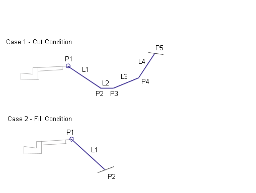

The following table lists the point, link, and shape codes for this subassembly that have codes assigned to them. Point, link, or shape codes for this subassembly that do not have codes assigned are not included in this table.
Point, Link, or Shape |
Codes |
Description |
P1 |
Hinge Hinge_Fill |
Fill condition only - hinge point for fill daylight link |
P2 |
Ditch_In Daylight Daylight_Fill |
Cut condition only - inside edge of ditch Fill condition only - daylight point |
P3 |
Ditch_Out |
Cut condition only - outside edge of ditch |
P4 |
Hinge_Cut |
Cut condition only - hinge point for cut daylight link |
P5 |
Daylight Daylight_Cut |
Cut condition only - daylight point |
L1 - L4 |
Top Datum |
Unpaved finish surface |
L1 |
Top Datum Daylight Daylight_Fill |
Daylight link in fill |
L4 |
Top Datum Daylight Daylight_Cut |
Daylight link in cut |
