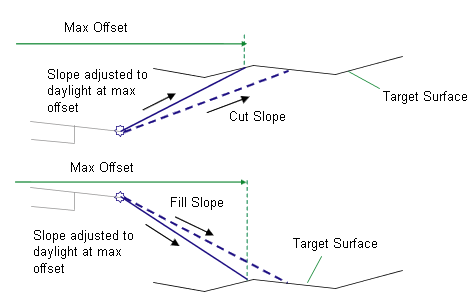

This subassembly inserts a link that extends to a target surface at a user-defined cut or fill slope.
If necessary, the slope is adjusted to keep the daylight point within a maximum +/- offset from the baseline.
You can also specify optional lined materials for daylight and other links (All Links, Daylight Links, Fill Links Only, and None).
The attachment point is at the hinge point of the daylight link. This component can be attached to either the left or right side.
Note: All dimensions are in meters or feet unless otherwise noted. All slopes are in run-over-rise form (for example, 4 : 1) unless indicated as a percent slope with a “%” sign.

This subassembly attempts to calculate a daylight point for the cut condition. If a daylight point is found, its offset is compared to the Max Offset value. If the Max Offset value is exceeded, the daylight point is moved to the maximum offset point on the target surface. If no cut daylight point is found, the process is repeated for the fill condition.
If an offset horizontal alignment name is assigned to the Max Offset during corridor modeling, the value of the Max Offset will vary to match the offset of the alignment.

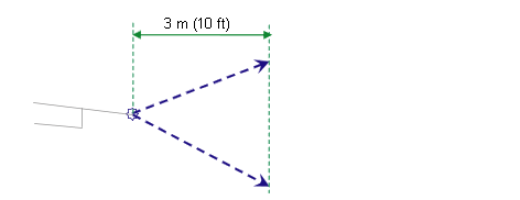

In layout mode, this subassembly displays both the cut and fill slopes in dashed lines extended outward for a distance of 3 meters or 10 feet. The daylight links are terminated with arrowheads pointing outwards.

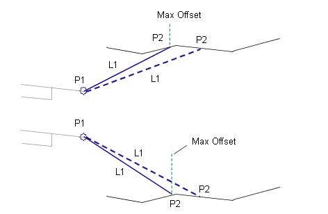

The following table lists the point, link, and shape codes for this subassembly that have codes assigned to them. Point, link, or shape codes for this subassembly that do not have codes assigned are not included in this table.
Point, Link, or Shape |
Code |
Description |
P1 |
Hinge Hinge_Cut or Hinge_Fill |
Hinge point, and hinge point for the cut or fill condition |
P2 |
Daylight Daylight_Cut or Daylight_Fill |
Daylight point, and daylight point for the cut or fill condition |
L1 |
Top Datum |
L1 |
Top Datum Daylight Daylight_Cut |
Daylight link for cut section |
L1 |
Top Datum Daylight Daylight_Fill |
Daylight link for fill section |
