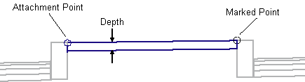

This subassembly inserts links for a constant-slope raised central reserve between two points.
Use the MarkPoint subassembly first if the connecting point has not already been marked.
The attachment point may be at either edge of the central reserve finished surface. The marked point must be at the opposite edge.

Marked Point
Name of the marked point on the central reserve edge opposite the attachment point
String
None
Depth
Depth of the central reserve cap. May be zero for an unpaved central reserve
Numeric, positive
0.100 m

The top of central reserve link is inserted between the attachment point and marked point. If a non-zero Depth is given, the bottom of central reserve link is inserted parallel to the top, and vertical links are added to close the shape.

P1, P2
None
Edges of central reserve on finish surface
P3, P4
L1
Top
Top of central reserve
L2
Datum
Bottom of central reserve
L3, L4
None
S1
Central Reserve
