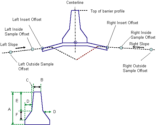

This subassembly widens an existing divided highway by extending from the travel lane edges inward over a depressed central reserve, with a symmetrical barrier at the centerline. The central reserve slopes may vary somewhat from the existing slopes to make both sides meet at the centerline, or to hold the top of the barrier to a profile.
The attachment point is at the midpoint of the base of the barrier.

Dimension A (mm or inches) |
Height of the barrier from the base on the high side of the central reserve to the top of the barrier. |
Numeric, positive |
810 mm 32 in |
Dimension B (mm or inches) |
As shown in diagram. |
Numeric, positive |
232 9 in |
Dimension C (mm or inches) |
Numeric, positive |
59 mm 2 in |
Dimension D (mm or inches) |
Numeric, positive |
125 mm 5 in |
Dimension E (mm or inches) |
Numeric, positive |
557 mm 22 in |
Dimension F (mm or inches) |
Numeric, positive |
178 mm 7 in |

In layout mode, a central reserve and barrier are drawn with the fixed dimensions as shown in the following diagram. This is the same figure that is drawn in layout mode for the OverlayCentralReserveAsymmetrical subassembly.
