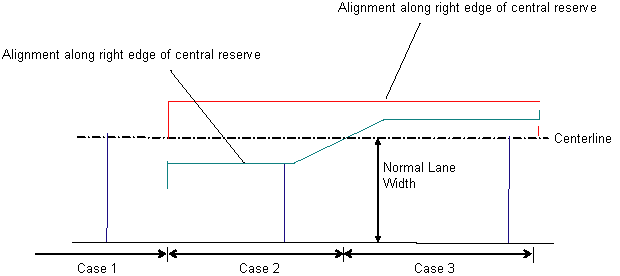

This subassembly inserts one or more travel lanes outward at a constant gradient from an alignment that defines the edge of a central reserve that tapers to allow for left-turning lanes.
The alignment defining the edge of the central reserve may at times be either not present (Case 1), outside the carriageway centerline (Case 2), or inside of the centerline (Case 3). To use this subassembly you should have separate alignments defining the left and right edges of the central reserve. It may be necessary to define separate corridor model regions for each individual central reserve.
The attachment point is at the location where the inside edge of carriageway would be if there was no central reserve. This is typically at the assembly baseline, but may be at any marker point on the assembly.

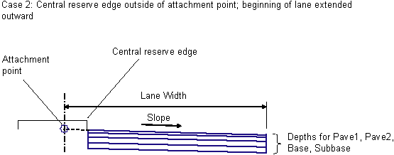

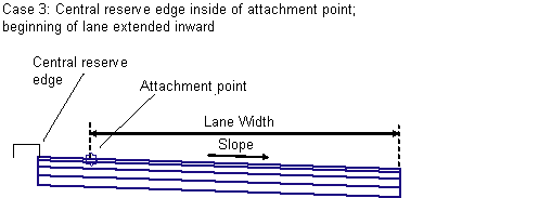

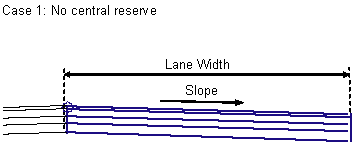

The location of the inside edge of carriageway is calculated based on the three cases shown in the preceding diagram. If no Central Reserve Edge alignment is given, or the given one is not found at a chainage, the inside edge is held at the attachment point (Case 1). If a Central Reserve Edge alignment is given, and that alignment is outside the lane’s attachment point, the inside edge is shifted outward from the attachment point at lane slope (Case 2). If the Central Reserve Edge alignment is inside the lane’s attachment point, the inside edge is shifted inward from the attachment point at the lane slope (Case 3).

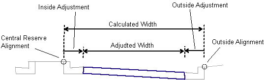

Inside and Outside Adjustments: The Inside Adjustment and Outside Adjustment parameters are provided in case the alignment used for the central reserve edge or lane edge is at a fixed offset from the actual edge of carriageway. For example, the alignment being used for the Central Reserve Edge may be at the back-of-kerb instead of at the pavement edge. In this case the Inside Adjustment parameter should be set to the width of the kerb.

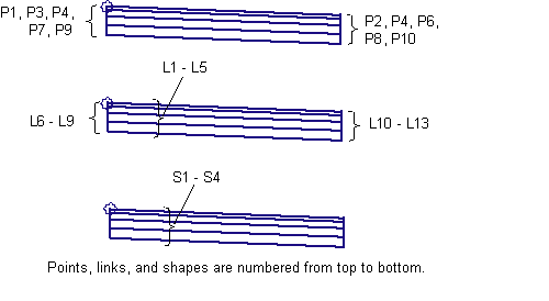

The following table lists the point, link, and shape codes for this subassembly that have codes assigned to them. Point, link, or shape codes for this subassembly that do not have codes assigned are not included in this table.
Point, Link, or Shape |
Code |
Description |
P1, P2 |
EC |
Edges of lane on finish surface |
P3, P4 |
EC_Pave1 |
Edges of lane on Pave1 layer |
P5, P6 |
EC_Pave2 |
Edges of lane on Pave2 layer |
P7, P8 |
EC_Base |
Edges of lane on Base layer |
P9, P10 |
EC _Sub |
Edges of lane on Subbase layer |
L1 |
Top, Pave |
Finish surface |
L2 |
Pave1 |
Pave1 surface |
L3 |
Pave2 |
Pave2 surface |
L4 |
Base |
Base surface |
L5 |
SubBase, Datum |
Subbase surface |
S1 |
Pave1 |
Area between finish surface and Pave1 |
S2 |
Pave2 |
Area between Pave1 and Pave2 |
S3 |
Base |
Area between Pave2 and Base |
S4 |
SubBase |
Area between Base and Subbase |
