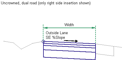

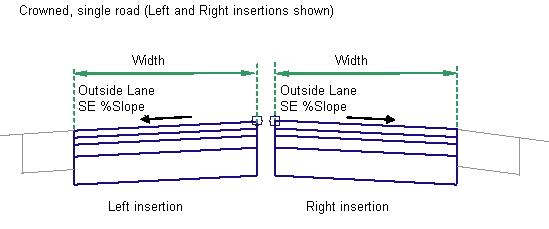

The attachment point is (a) at the inside edge of lane on finished gradient, if the insertion point is Crown, or (b) at the outside edge of travel way,if the insertion point is at the edge of travel way. This component can be attached to either the left or right side.

Side
Specifies which side to place the subassembly
Left / Right
Right
Insertion Point
Specifies insertion point of the lane either at the crown, or at the edge of travel way
List of options: (a) Crown, (b) Edge of Travel Way
Crown

Width
Width of the lane from the offset of the inside edge to the offset of the outside edge
Numeric, positive
3.6 m
12.0 ft
