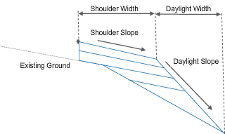

This subassembly inserts a shoulder for widening situations that will trim the base and subbase layers based on the location of the existing ground surface.
The attachment point is at the inside edge of the shoulder on the finish surface.

| Shoulder Width | Width from the attachment point to the shoulder hinge point | Numeric |
1.8 m 5.40 ft |
| Use Superelevation Slope |
Specifies to use superelevation slope, from the superelevation specification defined on the baseline alignment, for the paved portion of the shoulder. |
Selection List:
No |
| Shoulder Slope Direction |
Specifies whether the shoulder slopes away from the crown or towards the crown |
Selection List:
Away from Crown |
| Default Shoulder Slope | Default crossfall of the shape surface. This value is used if superelevation slope is not used, or is not specified for the baseline alignment. | Numeric | - 2.0 % |
| Subbase Daylight Type | Select whether to hold the daylight link to a fixed slope with variable width, or hold it to a fixed width with variable slope | Selection list: a) Hold Slope, Adjust Width, b) Hold Width, Adjust Slope | Hold Slope, Adjust Width |
| Daylight Slope | The value of the fixed slope of the daylight link, used if the “hold slope” option is used | Numeric, positive | 4 ( : 1) |
| Daylight Width | The value of the fixed width of the daylight link, used if the “hold width” option is used | Numeric, positive |
5.40 ft 1.8 m |

| Parameter | Description | Type |
| Daylight Slope | Slope of the daylight link | Numeric |
| Daylight Offset | Offset of the subgradient daylight point | Numeric |
| Daylight Level | Level of the subgradient daylight point | Numeric |
Shoulder Width |
Width of the paved shoulder |
Numeric |
| Shoulder Slope |
Slope of the paved shoulder |
Numeric |
When inserted, this subassembly checks for the presence of the target existing ground surface. If this surface exists, then the base and subbase surfaces will be trimmed to the existing ground.
If the surface does not exist, then this shoulder behaves the same as the ShoulderExtendAll subassembly.
In layout mode, this subassembly displays the links defined by the input parameters.
