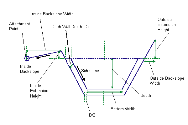

SideDitch
The subassembly is used to create a ditch structure with optional backslope and foreslopes.
The attachment point is the innermost point on the grading links preceding the ditch structure. If grading links are omitted, then the attachment point is the innermost point on the inside wall of the ditch structure (shown in blue circle).
Input Parameters
Note: All dimensions are in meters or feet unless otherwise noted. All slopes are in run-over-rise form (for example, 4 : 1), unless indicated as a percent slope with a “%” sign.
Parameter Description Type Default
Side
Specifies to insert the subassembly either on the right or the left side of the attachment point.
Left / Right Right
Depth Inside depth of the ditch. Numeric, Positive
0.45 m
1.5 ft
Bottom Width Width of bottom of the drainage channel. Numeric, Positive
0.5 m
1.5 ft
Sideslope Ditch sideslopes Numeric 1:2
Ditch Wall Depth Depth of the ditch wall. This is measured perpendicular to the side of the slope, as shown in the previous diagram. Numeric, Positive
0.1 m
0.33 ft
Inside Extension Height Non-lined extension of ditch inside over the attachment point Numeric, Positive
0.15 m
0.45 ft
Inside Backslope Width Ditch backfill width on the inside Numeric, Positive
1.5 m
5.0 ft
Outside Backslope Width Width of non-lined width beyond the outer point of the ditch structure Numeric, Positive
0.1 m
0.33 ft

Behavior
The subassembly builds the shape for a ditch structure, as shown in the above illustration.
Note:
In AutoCAD Civil 3D 2010 and previous versions, the Ditch Wall Depth parameter was measured vertically. In AutoCAD Civil 3D 2011 and later, this parameter is measured perpendicular to the side of the slope. Therefore, if you open a drawing containing these subassemblies that was created in AutoCAD Civil 3D 2010 or prior in AutoCAD Civil 3D 2011 or later, and then rebuild the corridor(s), this parameter will be changed to reflect the new behavior. Any volume reports that use this subassembly will be updated to reflect the new behavior.
Layout Mode Operation
In layout mode, this subassembly is created outward, starting from the attachment point, as defined using the input parameters.
