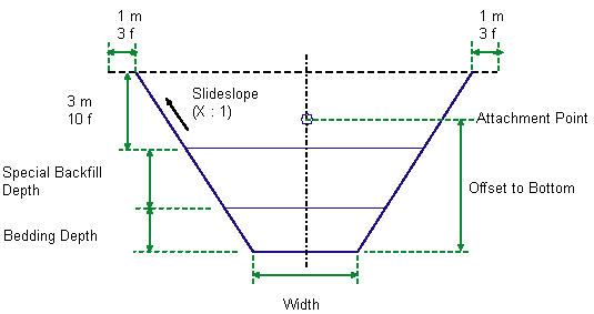

This subassembly creates a flat-bottom trench with equal sideslopes and up to three layers of backfill material.
The attachment point is at the Offset To Bottom distance above the midpoint of the base of the trench.

Width
Width of the bottom of the trench
Numeric, positive
2.0 m
6.0 ft
Sideslope
X : 1 slope of the trench sideslopes
Numeric, positive
3 : 1
Bedding Depth
Depth of the bedding layer
Numeric, positive
0.0
Special Backfill Depth
Depth of the special backfill layer
Numeric, positive
0.0
Offset to Bottom
The vertical offset down from the profile gradient line level to the bottom of the trench. For example, if the profile runs along the top of a circular pipe, the vertical offset is the pipe diameter plus the distance from the bottom of the pipe to the bottom of the trench.
Numeric
0.0
Behavior

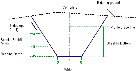

The level of the bottom of the trench is calculated as the profile gradient line level minus the Offset To Bottom value. The horizontal trench bottom link is placed symmetrically about the attachment point offset at that level, and the sideslopes are extended upward to the Existing Surface. The horizontal Bedding link is placed at the given depth above the trench bottom. The horizontal Special Backfill link is placed at the given depth above the Bedding link.

In layout mode, the trench and existing surface are drawn as shown below.
