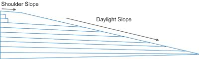

This subassembly inserts a shoulder that you can use to control superelevation. It is intended to work in combination with the LaneInsideSuperMultiLayer subassembly and supports Pave 1 through Pave 10 layer extension.
The attachment point is at the inside edge of the paved shoulder, which is typically at the outside edge of carriageway.
Note: All dimensions are in meters or feet unless otherwise noted. All slopes are in run-over-rise form (for example, 4 : 1) unless indicated as a percent slope with a “%” sign.

The finish surface of the shoulder is inserted for the given Shoulder Width and Default Shoulder Slope outward from the attachment point. The shoulder daylight link can be inserted with either a fixed slope (Daylight Type = Slope), or a fixed width (Daylight Type = Width). If a fixed slope is used, the daylight link is extended from the outside edge of the shoulder until it intersects the bottom link (L11). Otherwise, the bottom layer is extended for the Daylight Width beyond the outside edge of the shoulder, and the daylight link is connected to the end of the bottom. All links follow the slope of top link (L1).
In layout mode, this subassembly displays the links comprising the shoulder for a normal crowned carriageway situation. If numeric slope values are given for the Shoulder % Slope and Subbase % Slope, the links are shown at the given slope values. Otherwise the default slopes of -6% are used.
