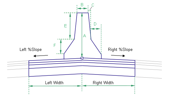

This subassembly inserts surfaces to define a flush central reserve with an optional New Jersey Barrier.
The pavement structure follows the standards described in “Pavement Structure of Paved Sections" in the AutoCAD Civil 3D Help.
The attachment point is at the center of central reserve on the finish surface surface. This component inserts to the left and right side simultaneously.
Note: All dimensions are in meters or feet unless otherwise noted. All slopes are in run-over-rise form (for example, 4 : 1) unless indicated as a percent slope with a “%” sign.

Dimension A (mm or inches) |
Height of the barrier at the center of central reserve |
Numeric, positive |
810 mm 32 in |
Dimension B (mm or inches) |
As shown in diagram |
Numeric, positive |
232 9 in |
Dimension C (mm or inches) |
Numeric, positive |
59 mm 2 in |
Dimension D (mm or inches) |
Numeric, positive |
125 mm 5 in |
Dimension E (mm or inches) |
Numeric, positive |
557 mm 22 in |
Dimension F (mm or inches) |
Numeric, positive |
178 mm 7 in |

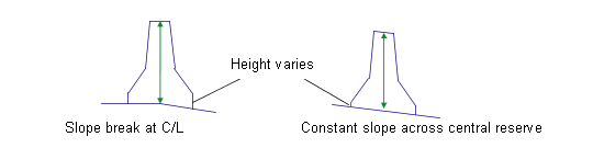

The pavement structure links are inserted outward left and right of the attachment point for the given widths and slopes. If the Include Barrier value is True, a New Jersey barrier is inserted symmetrically about the central reserve centerline. If alignments are given as target parameters for the Left and Right Widths, the widths are adjusted to tie to the alignment offsets at each chainage along the corridor.
If the central reserve is in superelevation with a single constant slope across the entire central reserve, the top of the barrier is slanted to match the central reserve slope. Otherwise the top of the barrier remains horizontal. In all cases, the barrier height (Dimension A) is held constant at the centerline of the barrier.
This subassembly works only with Carriageway Types that have a Pivot Method of Central Reserve Edges and a Central Reserve Treatment of Maintain Central Reserve Shape. If you use this subassembly with any other Pivot Method or with Distorted Central Reserve Treatment, it will produce a result equivalent to Central Reserve Edges with Maintain Central Reserve Shape.
In layout mode, this subasssembly displays all pavement links using the width and depth input parameters at a -2% slope. If Include Barrier is True, the barrier is displayed with the given dimensions.
