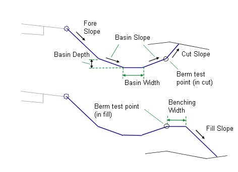

This subassembly inserts links to create a basin and cut daylight slope for a cut condition, or a basin, benching, and fill slope for a fill condition.
The final daylighting link can be omitted in cases where the corridor model needs to be left in an incomplete state. For example, this might be done so that grading surfaces on adjacent properties can tie to the hinge point on the uncompleted carriageway.
You can also specify optional lined materials for daylight and other links (All Links, Daylight Links, Fill Links Only, and None).
The attachment point is at the inside edge of the basin foreslope. This component can be attached to either the left or right side.
Note: All dimensions are in meters or feet unless otherwise noted. All slopes are in run-over-rise form (for example, 4 : 1) unless indicated as a percent slope with a “%” sign.

The subassembly builds the links for the basin foreslope and basin out to the basin test point. If a profile is given, the width of the foreslope varies to hold to the basin profile, while the basin depth is held constant. If the basin test point is in cut, the daylight intercept is calculated on the target surface at the given Cut Slope. If it is in fill, a top-of-benching link is added, and the daylight intercept is calculated on the target surface at the given Fill Slope. The daylight link is not inserted if Omit Daylight Link is set to True. If the top-of-benching link intersects the target surface, the section is terminated at the intersection.
