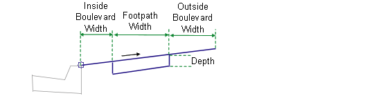

UrbanFootpath
This subassembly inserts links for a concrete footpath with inside and outside grass boulevards.
The attachment point is at the inside edge of the inside boulevard. The UrbanFootpath subassembly is typically attached to a back-of-kerb or edge of pavement.

Behavior
The inside grass strip, footpath, and outside grass boulevard links are inserted outward from the attachment point at the given slope. The grass strips can be omitted by specifying a zero-width.
Optionally, various element widths can be attained by attaching to offset alignments. Also, the footpath crossfall can be derived by tying into an offset profile.

Coding Diagram
