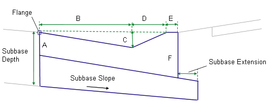

Dimension A
Depth of the channel at the flange point
Numeric, positive,
non-zero
150 mm
6 in
Dimension B
Width from the channel flange point to the channel invert level
Numeric, positive,
non-zero
610 mm
24 in
Dimension C
Depth from the channel flange point to the channel invert level, and from the channel invert level to the top-of-kerb
Numeric, positive,
non-zero
100 mm
4 in
Dimension D
Width from the channel invert level to the top-of-kerb
Numeric, positive,
non-zero
225 mm
9 in
Dimension E
Width from the top-of-kerb to back-of-kerb
Numeric, positive,
non-zero
75 mm
3 in
Dimension F
Height of the back-of-kerb
Numeric, positive,
non-zero
300 mm
12 in

The kerb and channel links are inserted based on the Input Parameter dimensions Dimension A – Dimension F. All dimensions must be positive, non-zero values. If a non-zero subbase depth is given, the subbase layer is inserted to the back of kerb, and continues for the Subbase Extension width. The subbase layer closes to the bottom-back-of-kerb, as shown in the diagram.
The subassembly builds the shape for a simple kerb and channel, with the attachment point either at (a) inside edge of the channel (or lip), or (b) the back of the kerb. The face of the kerb is given a small, constant width to make it non-vertical.
